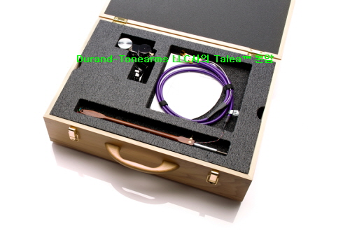

Durand-Tonearms LLC»çÀÇ Talea¢â Åæ¾Ï
2009³â Durand Tonearms LCC»ç´Â ÇÁ¶û½º ÀÛ°î°¡ÀÎ Joël-François Durand¿¡ ÀÇÇØ ¼³¸³µÇ¾ú´Ù. ±×´Â ÇÏÀÌ¿£µå±Þ Åæ¾ÏÀ» °³¹ßÇϱâÀ§ÇØ È¸»ç¸¦ ¼¼¿üÀ¸¸ç 2Á¾·ù ƯÇã·Î Á¦ÀÛÇÑ ¸ðµ¨ Talea¢â°ú Telos¢âÀ» ¼Ò°³Çß´Ù..
ÀÌÁß Ã¹ ¹øÂ° Á¦Ç°ÀÎ Talea¢â Åæ¾ÏÀº 2010³â ¹Ì±¹ Ç÷θ®´Ù ÁÖÀÇ Jacksonville¿¡¼­ ¿­¸° Axpona audio Àü½Ãȸ¿¡ ÃâǰÇß´Ù. ÀÌ Á¦Ç°Àº ´ç½Ã¿¡µµ °¡Àå ÀÌ»óÀûÀÎ Åæ¾ÏÀ¸·Î ¼±Á¤µÈ¹Ù ÀÖ´Ù.

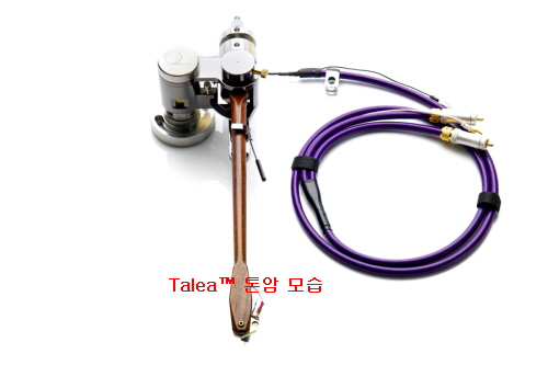

Talea ¢â Åæ¾ÏÀº ¹æÀ§°¢ ¼³Á¤À» À§ÇÑ µ¶Æ¯ÇÑ ¸ÞÄ¿´ÏÁòÀ» Á¦°øÇϰí ÀÖ´Ù. »õ·Î¿î ƯÇã Ãâ¿øÁßÀÎ ±â¼ú ´öºÐ¿¡ ¹æÀ§°¢À» Á¶Á¤ÇÏ´Â ±â´ÉÀ» Á¦°øÇÏ´Â ÃÖÃÊÀÇ Åæ¾ÏÀÌ µÇ¾ú´Ù. À½¾ÇÀ» µéÀ¸¸ç ¹Ì¼¼ Á¶Á¤ ÇÒ ¼ö´Â ¾øÀ¸³ª ÀÌ Åæ¾ÏÀº ¹æÀ§°¢ Ÿ¿öÀÇ Ãø¸é¿¡ ÀÛÀº º¼Æ®¸¦ µ¹·Á ·¹Äڵ带 Àç»ýÇϸ鼭 ±×°ÍÀº ÇÒ ¼ö°¡ ÀÖ´Ù.
º£¾î¸µÀº Unipivot ½ºÀ§½º Á¦ÀÛ non-corrosive, non-magnetic stainless steel pivot in a sapphire jewel

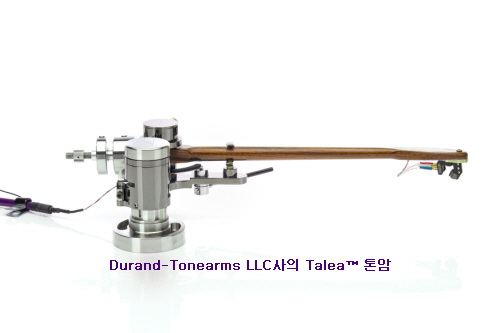

Talea¢â Åæ¾Ï Àç¿ø
¼³°è¹æ½Ä: IÀÚÇü Åæ¾Ï
½ÇÈ¿Àå: 263mm(10.35¡±)
ºñÆýÆ®-½ºÇɵé°Å¸®: 247.37mm
¿À¹öÇà: 15.66mm.
¿ÀÇÁÁþ°¢µµ(Offset angle) : 20.81
īƮ¸®Áö ¸¶¿îÆ®: 1/2¡±
¸¶¿îÆÃ°Å¸®(½ºÇɵé): 207.8-220.2mm(8.3-8.7¡±)
¸¶¿îÆÃȦũ±â: 10-24(¸ÞÅ» ½ºÅ©·ç)
Áß·®: 2.3lbs(1.04kg)
º¸´Ù ÀÚ¼¼ÇÑ Á¦Ç° Àç¿øÀº µ¿»ç°¡ ¼³¸íÇϰí ÀÖ´Â ¿ø¹®À» ÂüÁ¶ÇϽñ⠹ٶø´Ï´Ù.
Effective length: 263 mm (10.35¡±)
Pivot-spindle distance: 247.37 mm (Loefgren A geometry). Because the pivot is offset from the VTA tower, the Talea¢â can be mounted in the position of a 9¡± tonearm
Overhang: 15.66 mm. Effective length fine adjustment is realized with a cartridge plate on which the cartridge is mounted (Please see our page on cartridge alignment here)
Offset angle: 20.81 degrees.
Cartridge mount: 1/2¡±
Mounting distance (from spindle): 207.8-220.2 mm (8.3-8.7¡±). If you want to make sure that the Talea¢â will fit on your turntable, you can download a mounting template here (click on tab ¡°Talea¢â Mounting Templates¡±).
Mounting hole dimensions: 10-24 (metal screws) or #8 (wood screws). Mounting on the plinth/armboard is done with 2 bolts (for metal armboards) or 4 screws (for wood armboards). No large central hole needs to be bored
Weight of the whole assembly: ca. 2.3 lbs (1.04 kg)
Bearing: Unipivot, Swiss-made non-corrosive, non-magnetic stainless steel pivot in a sapphire jewel
VTA: on the fly fine adjustment, with knob; each turn of the knob corresponds to 0.5 mm change in height, thanks to an extremely precise 50 TPI thread (finer than micrometer thread). Maximum range: 23 mm. The VTA tower is fastened to the inner column with a clamp mechanism, ensuring maximum mating and rigidity between the parts
Azimuth: adjustable on the fly (patent-pending technology). We discuss the question of azimuth setting here
Progressive and adjustable anti-skating mechanism; can be disabled if desired
Counterweights: 130 g, 95 g, 60 g; with additional fine adjust weight to allow adjustment of VTF in small increments (typically +/- 0.1 g). The Talea¢â is a medium mass tonearm, and the combination of counterweights provided with it allows use of most cartridges currently available. The Talea¢â has been successfully tested with cartridges from 5 to 15 grams, with compliance from 8 to 20 µm/Mn
Phono cable uninterrupted from cartridge clips to termination connectors (available in unbalanced and balanced configuration); see below
Jig to set the pivot-to-spindle distance provided; no need for a ruler, the jig places the tonearm exactly in the right positio Arc protractor included
