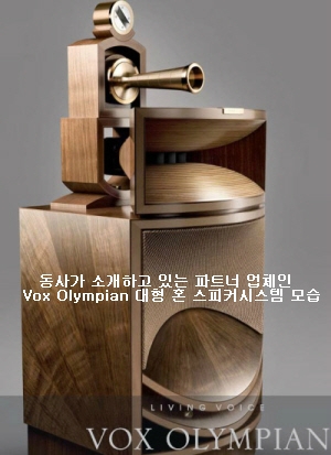

ÃÖ±Ù Living Voice»ç°¡ µ¿»ç°¡ÀÇ µå¶óÀ̹ö¸¦ »ç¿ëÇØ ¼³°èµÈ VOX OLYMPIAN½Ã½ºÅÛÀº ¿Àµð¿ÀÆÄÀϵéÀÇ °ü½ÉÀ» ¸ðÀº¹Ù ÀÖ¾î ´õ¿í ÁÖ¸ñµÇ°í ÀÖ´Ù.

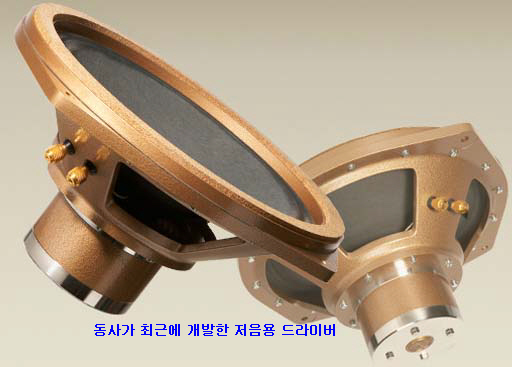

µ¿»ç´Â ±×µ¿¾È Vitavox»ç°¡ ³»³õÀº 15" Type K¿Í Type AK »õ½Ã µî ¸ðµç Áøµ¿ÆÇÀ» ¾ÖÇÁÅÍ ¼­ºñ½ºÇØ ÁÙ ¼ö ÀÖ°Ô ÁغñÇϰí ÀÖ´Ù. ´ÙÀ½Àº µ¿»ç°¡ ÃÖ±Ù¿¡ »õ·Î¿î Áøµ¿ÆÇ°ú ¿¾³¯ Áøµ¿ÆÇ¿¡ °üÇÑ ¼³¸íÀ» ÂüÁ¶ÇϽñ⠹ٶø´Ï´Ù.
We supply user replaceable cones for all 15" Type K and Type AK chassis loudspeakers. The cones are interchangeable, so performance specification can be readily changed. If you require a new cone for an old unit, please ensure you request the correct impedance and BR characteristics for the intended application, as previous cone replacements may mean that the driver type is misleading.

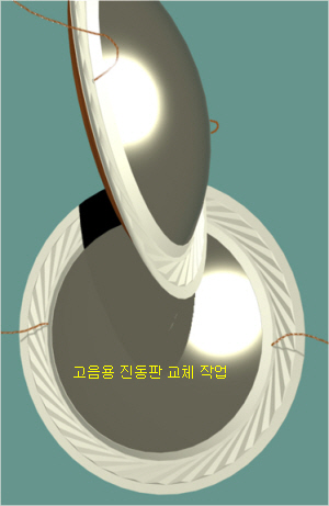

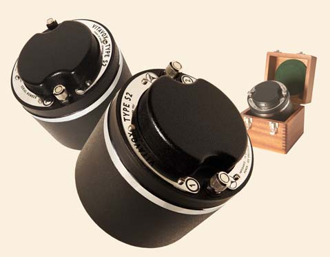

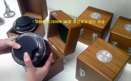

¶ÇÇÑ Vitavox»çÀÇ °íÀ½¿ë Æ®À§ÅÍÀÎ 'S' Type ±³Ã¼µµ °¡´ÉÇÏ´Ù°í Çϸç GP À¯´Öµµ Á¦°í°¡ ÀÖ¾î ±³Ã¼ °¡´É ÇÏ´Ù°í ÇÑ´Ù.
Replacement diaphragms for all Vitavox 'S' Type pressure units are available, and we also keep limited stocks for some GP units. All kits are supplied complete with washers and full fitting instructions.
In addition to holding a number of popular types in stock we offer a custom manufacture service for throat adaptors and ferrules. We can offer a number of material options and are happy to manufacture to customer drawings.
The drawings for most Vitavox loudspeaker products from the last 60 years are kept in our archives, and we also keep the original production tooling for many of these. If you have a cherished model that needs a new, genuine Vitavox part then give us a try, as if we don't hold it in stock, the chances are we can still manufacture it for you.

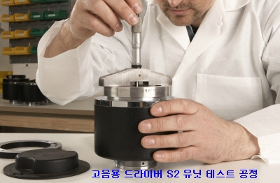

µ¿»ç´Â Vitavox 15"½ºÇÇÄ¿ µå¶óÀ̹ö¿Í S2 pressure °íÀ½¿ë À¯´Ö µîÀ» öÀúÇÏ°Ô 100% ¿ø»óÅ·Π¾ÖÇÁÅͼ­ºñ½º°¡ °¡´ÉÇÏ´Ù°í ÇÏ¸ç ¾î¶² ºÎºÐÀÇ ¼ö¸® ¶Ç´Â ±³Ã¼°¡ °¡´ÉÇÏ´Ù°í ÇÑ´Ù. ¶ÇÇÑ ÁÖ¿ë ºÎºÐÀÇ ÇÊ¿äÇÑ ¼¨½Ã¿Í ºÎǰ ±×¸®°í »ö»ó µîÀ» ¿øÇü º¹±¸°¡ °¡´ÉÇÏ´Ù°í ¾ð±ÞÇϰí ÀÖ´Ù.
ƯÈ÷ µå¶óÀ̹ö »óÅ¿¡ µû¶ó AlNiCo ¸¶±×³×Æ® ¾î¼Àºí¸®µµ °¡´ÉÇϸç È¿À²ÀûÀÌ°í °­·ÂÇϰí, ¾ÆÁ÷ ¸î ½Ê ³â µ¿¾È Àß »ç¿ë ÇÒ ¼ö ÀÖ°Ô²û ÃÖ´ëÇÑÀÇ ¼­ºñ½º¸¦ Á¦°øÇÒ ¼ö ÀÖ´Ù°í ÇÑ´Ù.
Durability and serviceability are key to the Vitavox design philosophy. Whatever the age of your Vitavox 15" loudspeaker or S2 pressure unit, and however physically challenging its life might have been, we can assure you that it remains 100% serviceable.
Should it prove necessary, any part can be repaired or replaced, and if required chassis components can be re-finished in standard or custom colours.
Depending on their particular environmental and usage circumstances, AlNiCo magnet assemblies can lose charge to a greater or lesser extent as the years pass.
We can offer a full recharging service to ensure that your driver's AlNiCo magnet assembly is as efficient and powerful today as when it was first built, and good for a few decades yet.
Recone kits are available for user fitting but if you'd rather, then we can supply and fit them for you here at the factory, and throw a gap clean and magnet recharge into the bargain!

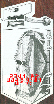

Åè ¸ð±×¸®Áö´Â 1940³â°æ ¹Ì±¹ÀÇ À¯¸íÇÑ ½ºÇÇÄ¿ Á¦Á¶ ±â¼úÀÚÀÎ Æú W. Ŭ¸³½¬°¡ °³¹ßÇÑ Å¬¸³½¬ È¥ÀÇ À̷п¡ µû¶ó¼­ µ¶ÀÚÀûÀΠȥÀ» Á¦ÀÛÇϱâ À§ÇØ ¿¬±¸¸¦ ½ÃÀÛÇß´Ù. ±×·¡¼­ 1947³â °¡Á¤¿ë ½ºÇÇÄ¿ ½Ã½ºÅÛÀ¸·Î´Â ÃÖ°íÀÇ °ÉÀÛÀ̶ó°í ¸»ÇÒ ¼ö ÀÖ´Â ¡®Å¬¸³½¬ µð½ºÆÛ½Ãºê¡¯¸¦ °³¹ßÇß°í, ÀÌ ½Ã½ºÅÛÀ¸·Î Á¦ÀÛµÈ ¸ðµ¨ÀÌ ¹Ù·Î CN-191ÄÚ³Ê È¥ ½ºÇÇÄ¿ ½Ã½ºÅÛÀÌ´Ù.
ÀÌ ½Ã½ºÅÛÀÇ ³»¿ëÀ» Àá½Ã »ìÆìº¸ÀÚ. ¸ð±×¸®ÁöÀÇ ¼¼¹ÐÇÑ ¼³°è¿¡ ÀÇÇØ ¸¸µé¾îÁø Ç® µ¥µåÈ¥ (KÇü È¥À̶ó°í ºÒ·¶´Âµ¥ À̴ Ŭ¸³½¬ È¥À» ¶æÇÑ´Ù) ÀÎŬ·ÎÀú¿¡ 15¡°(38cm)ÀúÀ½¿ë ¿ìÆÛ AK-155¸¦ žÀçÇØ ³õ¾Ò´Ù.

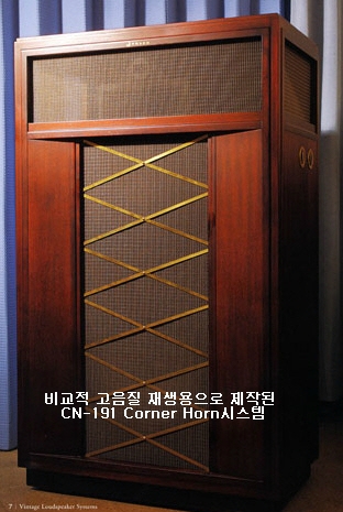

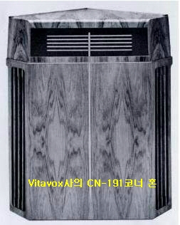

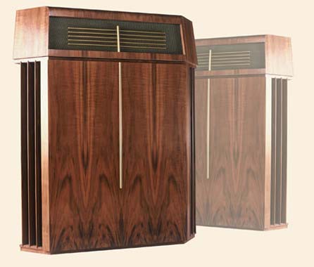

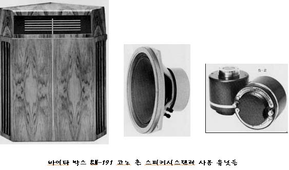

Vitavox»çÀÇ CN-191ÄÚ³Ê È¥
µ¿»ç°¡ ±ØÀå¿ëÀ¸·Î¼­ 1947³â¿¡ °³¹ß ¼Ò°³ÇÑ ´ëÇü ¸¶·çÇü ½ºÇÇÄ¿½Ã½ºÅÛ ¸ðµ¨ CN-191Àº ¹Ì±¹ Ŭ¸³»ç Á¦Ç°À» ¿¬»óÇÏ°Ô ¸¸µç Á¦Ç°À¸·Î ź³ëÀÌÀÇ ¿ÀÅä±×·¡ÇÇ ÀÎŬ·ÎÀú¿Íµµ ¸Å¿ì Èí»çÇÑ ÇüÅ·ΠÁ¦À۵Ǿî ÀÖ´Ù.
ÃÖ°í±Þ ±âÁ¾À¸·Î ¼Ò°³µÈ¹Ù ÀÖ´Â ÀÌ ¸¶·çÇü ½ºÇÇÄ¿½Ã½ºÅÛÀº °¡Á¤¿ëÀ¸·Î µðÀÚÀÎµÇ¾î ÆÇ¸ÅµÇ¾ú´ø Á¦Ç°À¸·Î È¥ ¼³°èÀÇ ÃÖ°íºÀÀ̶õ ¸»À» µé¾ú°í °¡Á¤¿ë ½ºÇÇÄ¿½Ã½ºÅÛÀ¸·Î¼­ ÀαⰡ ÀÖ¾ú´ø 3¿þÀÌ 3À¯´Ö ±¸¼º ¹æ½Ä.
½Ã½ºÅÛ À¯´Ö ±¸¼ºÀ» º¸°Ô µÇ¸é ÀÎŬ·ÎÀú »ó´Ü¿¡ ºÎÂø½ÃÄÑ ³õÀº °íÀ½¿ë µå¶óÀ̺꿡 ¸ðµ¨ S-2¸¦ À§½ÃÇØ °íÀ½¿ë È¥¿¡ CN-481 ±×¸®°í ÀúÀ½¿ë ¿ìÆÛ¿¡´Â AK-157À» ÀåÂøÇØ ³õ¾Ò´Ù. µð¹ÙÀ̵ù ³×Æ®¿öÅ©´Â ¸ðµ¨ NW-500ÀÌ »ç¿ëµÇ¾ú´Ù.
°íÀ½¿ë µå¶óÀÌºê ¸ðµ¨ S-2´Â ´ÙÀÌ¾Æ ÇÁ·½ÀÓ ¾Ë·ç¹Ì´½ ÇÕ±Ý ÀçÁúÀ̸ç ÀÚ¼®¹ÐµµÀÇ 16,000 Ä«¿ì½ºÀÌ´Ù. ÀúÀ½¿ë ¿ìÆÛ AK-157Àº ±¸°æÀÌ 380mmÀ̸ç ÀÚ¼®¹ÐµµÀÇ 14,000 Ä«¿ì½ºÀ̰í Áß·®Àº 11.34kg.ÀÌ´Ù. ÀÌ ½ºÇÇÄ¿½Ã½ºÅÛÀÇ Àüü Áß·®Àº 115kg.
AK-157 ÀúÀ½¿ë ½ºÇÇÄ¿ À¯´ÖÀ» ¾Õ¸é¿¡ ¹èÄ¡ÇØ ³õ°í, 4 ¸ÖƼ ¼¿·¯ È¥À» ÀÎŬ·ÎÀú »óºÎ¿¡ º°µµ·Î ¼³Ä¡ À½ÀÌ ¸í·áÇÏ°Ô È®»ê µÇµµ·Ï Çß´Ù. S2 ¾ÐÃà °íÀ½¿ª Æ®À§ÅͰ¡ Áß¡¤°í¿ªÀ» ´ã´çÇß°í, ³×Æ®¿öÅ©´Â 500Hz ÀÌÇϸ¦ Å©·Î½º ¿À¹ö ½ÃÄÑ ÀüüÀûÀÎ À½ÇâÀÌ °í¸£°Ô Àç»ýµÇµµ·Ï Á¦ÀÛµÈ °í±ÞÇü ½ºÇÇÄ¿ ½Ã½ºÅÛÀÌ´Ù.
¶ÇÇÑ º£À̽º ºó ½Ã½ºÅÛÀº ±ØÀå¿ëÀ¸·Î Ưº°È÷ Á¦ÀÛµÈ Á¦Ç°ÀÌ´Ù. ÀÌ Á¦Ç°Àº ´ÙÀ̳»¹ÍÇÑ »ç¿îµå¿Í °­·ÂÇÑ Ãâ·ÂÀ» ³¾ ¼ö ÀÖ´Â Àú À½¿ª À¯´Ö 2°³¸¦ ¼³Ä¡Çؼ­ dzºÎÇÑ À½·®À» ³¾ ¼ö ÀÖ°Ô Á¦ÀÛµÈ ¸ðµ¨ÀÌ´Ù.
ÀÌ ½Ã½ºÅÛ 500Hz ºÐÇÒ È¸·Î¸Á°ú 2°³ÀÇ AK-156 Àú À½¿ª µå¶óÀ̹ö·Î µ¿ÀÛÇϴµ¥, ´ÙÁß È¥(¸ÖƼ È¥)°ú Á¶ÀýÆÇÀÇ ¼³Ä¡°¡ Áß¿äÇÑ °ÍÀ¸·Î, À½·®À» Á¶ÀýÇØ ÁÖ°Ô µÈ´Ù.
µ¿»ç´Â ¸ÖƼ ¼¿¶ó È¥ÀÎ ¸ðµ¨ CN157À» °³¼±½ÃÄÑ ´Ù½Ã ¸¸µç ´ëÇü È¥ ¸ðµ¨ CN 481À» ¼Ò°³Çß´Ù. ÀÌ È¥Àº »çÁø¿¡¼­ º¼ ¼ö ÀÖµíÀÌ 4°³·Î ºÐ¸®½ÃÄÑ ³õÀº Á¦Ç°À¸·Î ¸ðµ¨ CN-191½Ã½ºÅÛ¿¡¼­ »ç¿ë Çѹ٠ÀÖ´Ù.
¾÷¹«¿ëÀ¸·Î´Â ¸ðµ¨ CN 121ÀÌ ÀÖÀ¸¸ç ÀÌ È¥Àº ´ëÃâ·Â¿ëÀ¸·Î Á¦ÀÛ Á¦À۵ǾúÀ¸¸ç ´ëÇü Ȧ µî¿¡ »ç¿ëÇÏ´Â ÀúÀ½¿ë ½Ã½ºÅÛÀ¸·Î´Â ¸ðµ¨ Bitone Major°¡ ÀÖ°í À̰ÍÀ» µÎ °³·Î ¼³°èÇÑ  Double Bitone Major½Ã½ºÅÛÀÌ ÀÖ´Ù. ÀÌ ¹Û¿¡ µ¿»ç°¡ ´ç½Ã¿¡ ³»³õÀº À¯´ÖµéÀ» »ìÆìº¸ÀÚ.

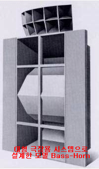

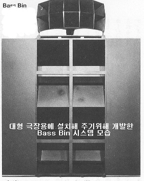

Bass-Bin½Ã½ºÅÛ
µ¿»ç°¡ ³»³õÀº ´ëÇü ±ØÀå¿ë ½Ã½ºÅÛÀ¸·Î ¼³°èÇÑ ¸ðµ¨ Bass-Horn½Ã½ºÅÛÀº °­·ÂÇÑ À½Çâ Ãâ·ÂÀ» ³¾ ¼ö ÀÖ°Ô µÇ¾î ÀÖÀ¸¸ç ¼ø ¾÷¹«¿ëÀ¸·Î ¼Ò°³µÈ Á¦Ç°ÀÌ´Ù. Àç»ý Á֯ļö ´ë¿ªÀº 20¢¦20,000(Hz)À̸ç ÀÓÇÇ´ø½º´Â 15¥Ø.
°íÀ½¿ë¿¡ £È£Æ µå¶óÀ̹ö S-2¸¦ È¥Àº CN-123À» »ç¿ëÇϰí ÀÖ°í £Ì£Æ µå¶óÀ̹ö¿¡´Â ¸ðµ¨ AK-157 2°³¸¦ žÀçÇØ ³õ¾Ò°í ³×Æ®¿öÅ©´Â NW-500 ¾Æµ¥³×ÀÌÅÍ´Â 0¢¦-8(dB)·Î »ç¿ë ÇÒ ¼ö°¡ ÀÖ°Ô µÇ¾î ÀÖ´Ù. ½Ã½ºÅÛÀÇ Áß·®Àº 170kgÀ̸ç Å©±â´Â 960W x 2,200H x 800D(mm).

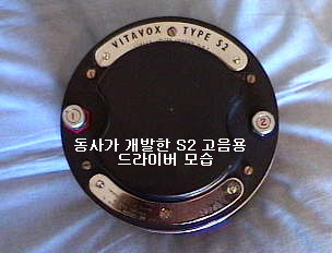

½ºÇÇÄ¿ À¯´Ö°ú S2 °íÀ½¿ª À¯´Ö
È¥¿¡ ºÎÂø½ÃÄÑ »ç¿ëÇϵµ·Ï µÇ¾î ÀÖÀ¸¸ç, À¯´Ö ³»°æÀÌ 2.620¡°(SÇü)·Î, °­·ÂÇÑ ¾Ë¸®ÄÚÇü ÀÚ¼®ÀÌ´Ù. ÀÓÇÇ´ø½º´Â 15¥ØÀÌ°í °¡Á¤¿ë½ºÇÇÄ¿ ½Ã½ºÅÛ¿¡ ¸¹ÀÌ »ç¿ëµÇ¾ú´Ù.
S2 µå¶óÀ̹ö Àç¿ø
Àç»ýÁ֯ļö´ë¿ª: 200¢¦20,000(Hz)
ÀÔ·Â: 100(W)
ÀÓÇÇ´ø½º: 15¥Ø
´ÙÀ̾îÇÁ·½: ¾Ë·ç¹Ì´½ ÇÕ±Ý
´ÙÀ̾ÆÇÁ·½ Å©±â: 76.2(mm)
ÀûÇÕÈ¥ : CN-481/220½Ã¸®Áî
ÀÚ¼®¹Ðµµ: 16,000(gauss)
ÃÑÀÚ¼®¹Ðµµ: 150,000(Maxwells)
Áß·®: 6.1(kg)
Å©±â: 127 x 135(mm)
