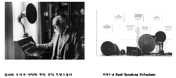

1898³â ¿Ã¸®¹ö ·ÎÁö(Oliver Lodge)´Â ¹«ºù ÄÚÀÏ Æ®·£½ºµà¼­ÀÇ ³»¿ÜºÎ Ç® °¸(air gap)À» À¯ÁöÇϱâ À§ÇÑ ºñÀÚ±âÇü ±¸Á¶¸¦ ÀÌ¿ë °³¼±µÈ ½ºÇÇÄ¿¿¡ ´ëÇÑ Æ¯Çã(9712)¸¦ 4¿ù 27ÀÏ¿¡ ¿µ±¹¿¡ Ãâ¿øÇß´Ù.
ÀÌ Æ¯Çã ±â¼úÀº ±×ÀÌ À̸§À» ¾Ë·ÁÁØ ´ç½Ã À¯¸íÇÑ ¶óµð¿À Æ©³Ê¿¡ »ç¿ëµÇ¾úÀ¸¸ç ±×°¡ ¸¸µç ½ºÇÇÄ¿ ¸ðµ¨Àº »ç¿ìÁî Ä˽ÌÅæ(South Kensington) °úÇÐ ¹Ú¹°°ü¿¡ Àü½ÃµÇ¾î ÀÖ´Ù.  ÀÌ Á¦Ç°¿¡ ´ëÇÑ »çÁøÀº 1927³â 12¿ù 21ÀÏÀÚ ¿ÍÀ̾½º ¿ùµå(Wireless World)¿¡ ½Ç·Á ±â»ç¿Í ÇÔ²² Ãâ¹Ý µÇ¾ú´Ù.
ÀÌ·¸°Ô °³¼±µÈ ÈÄ¿¡ ¸¶±×³×º¹½º(Magnavox)»çÀÇ ÇÁ¸®µåÇÜ(Pridham)°ú Àü¼¾(Jensen)ÀÌ Æ¯Çã 1448,279)·Î Ãâ¿ø 1923³â¿¡ ¹Þ¾Æ³Â´Ù. 1898 -Oliver Lodge filed for British patent No. 9712 on Apr. 27,1898, for an improved loudspeaker with nonmagnetic spacers to keep the air gap between the inner and outer poles of a moving coil transducer. This was the same year he applied for a patent on his famous radio tuner.
A model of his loudspeaker is in the British Science Museum in South Kensington, and a photo was published in Wireless World Dec. 21, 1927. This improvement was later claimed by Pridham and Jensen in the Magnavox application for patent No. 1,448,279 filed Apr. 28, 1920, and granted Mar. 13, 1923.

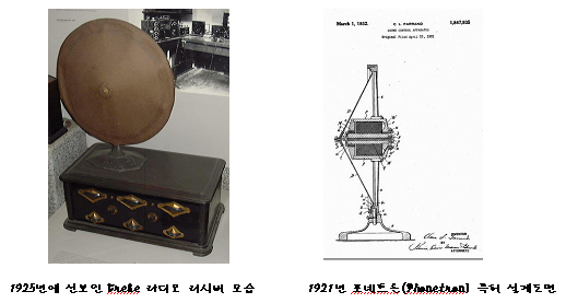

1921³â Æ÷³×Æ®·Ð(Phonetron)ÀÌ C. L. ÆÄ·£µå(C. L.Farrand)°¡ 4¿ù 23ÀÏÀÚ·Î ¹Þ¾Æ³½ ½ºÇÇÄ¿¿¡ °üÇÑ Æ¯Çã1,847,935·Î ¸¸µç ÃÖÃÊÀÇ ÄÚÀÏ Áøµ¿ ¹æ½ÄÀÇ ´ÙÀÌ·ºÆ® ¶óµð¿¡ÀÌÅÍ(direct-radiator)¼³°è ½ºÇÇÄ¿¸¦ ¹Ì±¹ ½ÃÀå¿¡ ÆÇ¸ÅµÇ¾ú´Ù.

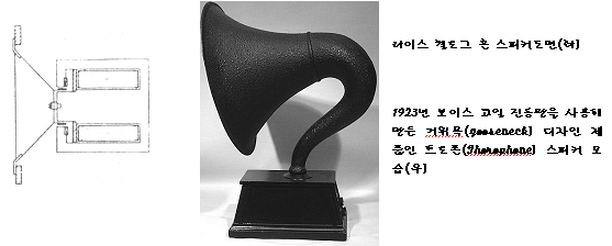

ÀÌ Á¦Ç°Àº Ź»ó¿ë ¶óµð¿À ¸®½Ã¹ö¿¡ È¥À» ºÎÂøÇÑ Á¦Ç°°ú °æÀïÇß´Ù. 1923³â º¸À̽º ÄÚÀÏ Áøµ¿ÆÇÀ» »ç¿ëÇØ ¸¸µç °ÅÀ§¸ñ(gooseneck) µðÀÚÀÎ Á¦Ç°ÀÎ Æ®·ÎÆù(Thorophone) ½ºÇÇÄ¿°¡ ¼±º¸¾ú´Ù.
1921-The Phonetron based on patent No. 1,847,935 filed Apr. 23, 1921, by C. L. Farrand, was the first coil-driven direct-radiator loudspeaker to be sold in the U.S. and was well-received, competing with the horns used by table radios. 1923 The Thorophone was a gooseneck loudspeaker with a voice-coil driver.

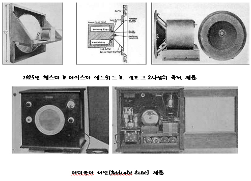

1925³â Á¦³Ê·² ÀÏ·ºÆ®¸¯»çÀÇ Ã¼½º´Ù W ¶óÀ̽º¿Í ¿¡µå¿öµå W. °Ö·Î±× 2»ç¶÷Àº ¹èÇÿ¡ ÀåÂøÇØ ÆòźÇÑ ÁßÀ½´ë¿ªÀ» Àç»ý ½ÃÄÑ ÁÙ ¼ö ÀÖ°Ô ¼ÒÇü ÄÚÀÏ·Î ¸¸µç Áøµ¿ÆÇÀ» ¿¬°áÇÑ ´ÙÀÌ·ºÆ® ¶óµð¿¡ÀÌÅÍ ½ºÇÇÄ¿ÀÇ ±âº» ¿ø¸®¿¡ °üÇÑ ³»¿ëÀ» ´ãÀº Áß¿äÇÑ ¿¬±¸ ³í¹®À» ¹ßÇ¥Çß´Ù.
ÇÑÆí º§¿¬±¸¼ÒÀÇ ¿¡µå¿öµå À¢Æ®(Edward Wente)µµ µ¶ÀÚÀûÀÎ ¿¬±¸¸¦ ÅëÇØ µ¿ÀÏÇÑ ¿ø¸®¸¦ ¹ß°ßÇÏ°í Æ¯Çã 1,812,389¸¦ 1925³â 4¿ù1ÀÏÀÚ·Î Ãâ¿ø 1931³â 6¿ù30ÀÏÀÚ·Î ¹Þ¾Æ³Â´Ù. ü½º´Ù W ¶óÀ̽º¿Í ¿¡µå¿öµå W. °Ö·Î±× ³í¹®¿¡´Â ¾ÚÇø®ÆÄÀ̾ ´ëÇÑ ¼³°è¿¡ °üÇÑ ³»¿ëµµ ´ã°í Àִµ¥ ½ºÇÇÄ¿¿¡ Àü´ÞÇÒ ¾ÚÇø®ÆÄÀ̾îÀÇ ÆÄ¿ö Áõ°­°ú °ü·ÃÇÑ Áß¿äÇÑ ³»¿ëÀÌ´Ù.
1926³â RCA»ç¿¡¼­´Â ÀÌ ¼³°è ¹æ½ÄÀ¸·Î Á÷·ù Àü¿øÀ» ÀÌ¿ëÇÑ µ¿»çÀÇ ¶óµð¿Ã¶ó ¶óÀÎ(Radiola line) Á¦Ç°¿¡ »ç¿ëÇß´Ù.
1925 - The research paper of Chester W. Rice and Edward W. Kellogg at General Electric was important in establishing the basic principle of the direct-radiator loudspeaker with a small coil-driven mass-controlled diaphragm in a baffle with a broad midfrequency range of uniform response.
Edward Wente at Bell Labs had independently discovered this same principle, filed patent No. 1,812,389 Apr. 1, 1925, granted June 30, 1931. The Rice-Kellogg paper also published an amplifier design that was important in boosting the power transmitted to loudspeakers. In 1926, RCA used this design in the Radiola line of a.c. powered radios.

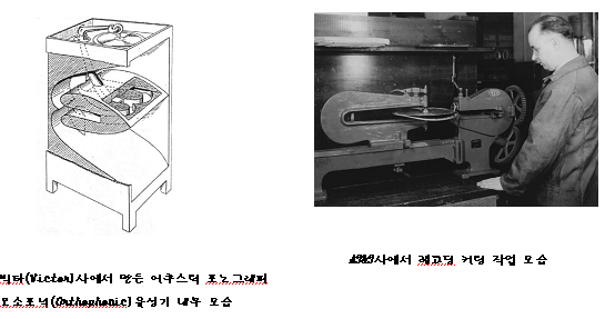

1925³â ºòŸ(Victor)»ç¿¡¼­ ¸¸µç ¾îÄí½ºÆ½ Æ÷³ë±×·¡ÇÇ ¿À¼ÒÆ÷´Ð(Orthophonic)À¯¼º±â Ç÷¹À̾î´Â Á¢À» ¼ö Àִ ȥÇü µðÀÚÀÎÀÇ ½ºÇÇÄ¿¸¦ ³»³õ¾Ò´Âµ¥ ÀÌ Á¦Ç°Àº ÈÄ¿¡ ¹Ì±¹ ½ºÇÇÄ¿ Àü¹® ¸ÞÀÌÄ¿·Î À¯¸íÇÑ Å¬¸³½¬(Klipsch)»ç°¡ ÇÏÀÌÆÄÀÌ Á¦Ç°¿¡ ÀÌ¿ëÇß´Ù.
ÀÌ Á¦Ç°À» °³¹ßÇØ ³»³õÀº Áö 1³âµµ µÇÁö ¾Ê¾Æ ºê·é½ºÀ¨ ¹úÅ© ÄÝ·£´õ ȸ»ç(Brunswick Balke Collender Co)¿¡¼­ ÆÇ¸ÅÇÏ´ø ºê·é½ºÀ¨ ÆÄ³ªÆ®·ÎÇÁ(Brunswick Panatrope) ó·³ ÀÏ·ºÆ®¸¯Äà ÇȾ÷, Áø°ø°ü ¾ÚÇø®ÆÄÀÌ¾î ±×¸®°í ¹«ºù ÄÚÀÏÇü ½ºÇÇÄ¿¿Í °áÇÕµÈ ´Ù¸¥ ¹æ½ÄÀÇ À¯¼º±âµé°ú °æÀïÀ» ¹ú¸®°Ô µÇ¾ú´Ù.
1925-Victor Orthophonic acoustic phonograph player had a folded exponential horn that was later used as model for the Klipsch speaker of the hi-fi era. Within a year, the Orthophonic faced competition from all-electric phonographs with an electro mechanical pickup, vacuum-tube amplifier, and moving-coil loudspeaker, such as the Brunswick Panatrope sold by the Brunswick-Balke-Collender Company.

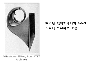

1926³â ¿µÈ­¿¡¼­ »ç¿ëµÇ¾ú´ø ºñŸÆù(Vitaphone)¼­¶ó¿îµå ½Ã½ºÅÛÀº º§¿¬±¸¼Ò¿¡¼­ °³¹ßÇÑ »õ·Î¿î ½ºÇÇÄ¿¿´´Ù. µ¿»çÀÇ ±â¼úÀÚÀÎ À¢Æ®(Wente)¿Í Æ©¶ó(Thuras)°¡ °³¹ßÇÑ ÀÌ Á¦Ç°Àº 1¡° ±¸°æÀ» °®Ãá È¥°ú 40 ½ºÄù¾î ÇÇÆ®ÀÇ ¿þ½ºÆ° ÀÏ·ºÆ®¸¯ 555-W µå¶óÀ̺ê. ÀÌ Á¦Ç°ÀÇ Àç»ý Á֯ļö ´ë¿ªÀº 100-5000Hz·Î ¼³°èµÇ¾î ÀÖ¾ú°í È¿À²Àº 25%À» °®Ãá Á¦Ç°ÀÌ´Ù. (ÇöÀç Á¦ÀÛµÇ¾î ¼Ò°³µÇ°í ÀÖ´Â Á¦Ç°ÀÇ È¿À²Àº 1% ³»¿Ü)À̰ÍÀº ´ç½Ã »ç¿ëÇÒ ¾ÚÇø®ÆÄÀ̾îÀÇ Ãâ·ÂÀÌ 10¿ÍÆ® Á¤µµ Àú Ãâ·Â ÀÌ¿©¼­ À̸¦ ±âÁØÇؼ­ ¼³°è µÈ °ÍÀ¸·Î ¸ðµ¨ 205-D ¾ÚÇø®ÆÄÀ̾ ä¿ëÇß´Ù. ±× ÀÌÀü¿¡ ½ºÇÇÄ¿´Â ¹ë·±½º Áøµ¿°èÇüÀ̾úÀ¸³ª »õ·Ó°Ô °³¹ßµÈ Vitaphone¿¡´Â 555-W´Â ¹«ºù ÄÚÀÏÇüÀ» äÅà ÇÑ °ÍÀÌ´Ù.
1926 - Vitaphone sound system for motion pictures used a new speaker developed at Bell Labs. Wente and Thuras designed the Western Electric 555-W speaker driver that was coupled with a horn having a 1-in. throat and a 40-sq. ft. mouth; it was capable of 100-5000 hz freq. range with an efficiency of 25% (compared to 1% today) needed due to low amp power of 10 watts.
The power amps were 205-D. Older loudspeakers were balanced armature type, but the newer 555-W speakers of the Vitaphone were moving coil type.

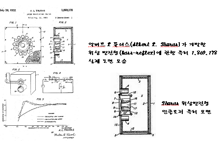

1930³â º§¿¬±¸¼Ò ¿£Áö´Ï¾îÀÎ ¾Ë¹öÆ® L Æ©¶ó½º(Albert L. Thuras)´Â À§»ó ¹ÝÀüÇü(bass-reflex)¿¡ °üÇÑ Æ¯Çã 1,869,178À» 1930³â 8¿ù 15ÀÏÀÚ·Î Ãâ¿øÇßÀ¸¸ç 1932³â 7¿ù26ÀÏ ÀÌ ¹æ½Ä ƯÇ㸦 ¹Þ¾î³Â´Ù.
ÃʱâÀÇ Ä³ºñ´Ö ¼³°è´Â ÆÐ½ÃÇÁ ¹æ½ÄÀ¸·Î Àü¸é¿¡¼­ ¹æ»çÇϵµ·Ï µÇ¾î ÀÖ°í ÀúÀ½ ´ë¿ªÀº ÈĸéÀÇ °³¹æ »óÅ·Π¸¸µç ÆÐ½Ãºê ¹èÇà ¹æ½ÄÀ̾ú´Ù. ÀÌ À§»ó ¹ÝÀüÇü ÀÎŬ·ÎÁ®´Â Áøµ¿ÆÇ ÈĸéÀÇ Àú ¿ª ¼Õ½ÇÀ» ¹æÁö ÇÒ ¼ö ÀÖ°Ô ¸¸µç °ÍÀÌ´Ù.
1930 - Albert L.Thuras filed patent No. 1,869,178 on Aug. 15, 1930, granted July 26, 1932, for the bass-reflex principle while working at Bell Labs. Early cabinets used a passive baffle to direct sound to the front, allowing the back of the cabinet to be open for the low sounds. The bass-reflex enclosure kept the low-frequency sounds from being lost from the rear of the diaphragm.

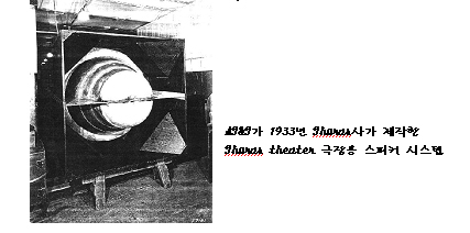

1932³â RCA»ç¿¡¼­´Â ±ØÀå¿ë µà¾ó ·¹ÀÎÁö ½ºÇÇÄ¿¸¦ °³¹ßÇß´Ù. 3°³ÀÇ 6¡° ±¸°æ ÄÜÇü Áøµ¿ÆÇ¿¡ ¾Ë·ç¹Ì´½ º¸À̽º ÄÚÀÏÀ» ¿ª ¹æÇâÀ¸·Î ºÎÂøÇß´Ù. Á֯ļö ´ë¿ªÀº 125~8000Hz¿¡ À̸£·¶À¸¸ç 40~`125Hz ´ë¿ª Àç»ýÀ» À§Çؼ­´Â 10ÇÇÆ® Å©±âÀÇ È¥À» ÀåÂøÇØ ³õ¾Ò´Ù.
1932 - RCA demonstrated a dual-range speaker of its own design for theaters, using three 6-inch cone diaphragms with aluminum voice coils in divergent directions, with a response of 125-8000 hz, and 10-ft. horns 40-125 hz.
1933³â »õ·Î¿î ½Ã½ºÅÛ¿¡ ÀÇÇÑ Áøº¸¶ó°í ÇÒ ¼ö ÀÖ´Â ½ºÅ×·¹¿ÀÆ÷´Ð½º(stereophonic) ¹æ½ÄÀÌ °³¹ßµÇ¾ú´Ù. ÀÌ ÀåÄ¡´Â °ø°£°¨¿¡ ´ëÇÏ¿© »õ·Ó°Ô ´«À» ¶ß°Ô ÇØÁÖ¾ú´Ù. 1933³â º½¿¡ ¿ö½ÌÅÏ¿¡ ÀÖ´Â ÄÁ½ºÆ¼Æ©¼ÇȦ¿¡¼­ ¸¹Àº ûÁßµéÀ» ¾Õ¿¡ µÎ°í ½Ã¿¬µÇ¾ú´Ù.
Çʶóµ¨ÇǾƿ¡ ÀÖ´Â ¹ÂÁ÷ ¾ÆÄɵ¥¹Ì ¿ÀÄɽºÆ®¶ó°¡ Á¿ì Áß°£ÀÇ 3°³ÀÇ ¸¶ÀÌÅ©¸¦ ÅëÇÏ¿© Àü¼ÛÇÑ À½¾ÇÀÌ ÄÁ½ºÆ¼Æ©¼ÇȦ¿¡ µ¿ÀÏÇÏ°Ô À§Ä¡½ÃÄÑ ³õÀº ½ºÇÇÄ¿¸¦ ÅëÇØ Èê·Á ³ª¿Ô´Ù. ÀÌ·¸°Ô Àü¼ÛµÈ À½¾ÇÀº À¢Æ® ¹Ú»ç(Dr. Wente) ¿Í Æ©¶ó½º(A. L. Thuras)°¡ Ưº°ÇÑ ¸ñÀûÀ» À§ÇÏ¿© °³¹ßµÈ ½ºÇÇÄ¿¸¦ ÅëÇØ Àç»ýµÇ¾ú´Ù.
ÀÌ ½ºÇÇÄ¿ÀÇ ¼³°è ¸ñÇ¥´Â ¿ÀÄɽºÆ®¶óÀÇ À½»öÀ» ±ÕµîÇÏ°Ô Àü´ÞÇÏ°í ºñ¼±Çü µð½ºÅä¼ÇÀÇ ¹ß»ýÀÌ ¾øÀ¸¸ç Àü ´ë¿ªÀ» ±ÕÀÏÇÏ°Ô Àç»ý½Ã۰íÀÚ ÇÔÀ̾ú´Ù. ÀÌ ½Ã¿¬À» À§ÇÏ¿© ´Ù¾çÇÑ Å©±âÀÇ È¥ÀÌ Á¦À۵Ǿú´Ù. ÀÌ °ø·Î¸¦ ÀÎÁ¤¹Þ¾Æ º§¿¬±¸¼ÒÀÇ À¢Æ®´Â 1936³â¿¡ ¾ÆÄ«µ¥¹Ì ¿µÈ­Á¦¿¡¼­ ±Ý»óÀ» ¼ö»óÇß´Ù.
1933-"Progress was such that a demonstration of the new system - called "stereophonic" because of its ability to give a spatial sense corresponding to stereoscopic vision - was given before the National Academy of Sciences and many invited guests at Constitution Hall, Washington in the spring of 1933.
Transmission was Thuras theater speaker 1933, from AT&T Archives over wire lines from the Academy of Music in Philadelphia and three channels were used with microphones respectively at left, center and right of the orchestra stage and loud speakers in similar positions in Constitution Hall."
This transmission of music "was carried out with special loud speakers developed for the purpose by Dr. Wente and the late A. L. Thuras. The objectives in the design of these loudspeakers were uniform response over the whole tonal range of the orchestra, an enhanced sound power output capacity without noticeable non-linear distortion and uniform distribution of the emitted sound at all frequencies throughout a wide solid angle.
For the receiving unit and the multicellular horn which were developed for this demonstration, Dr. Wente, jointly with the Bell Telephone Laboratories, was awarded a gold plaque by the Academy of Motion Picture Arts and Sciences in 1936." (Bell Labs, 1953)

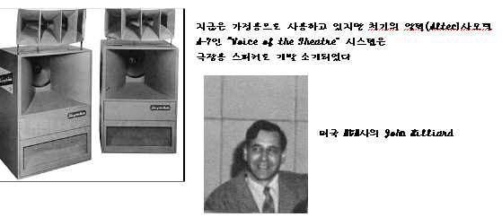

1935³â MGM»çÀÇ ´õ±Û·¯½º ½¬¾î(Douglas Shearer)¿Í Á¸ È÷¶óµå(John Hilliard)´Â ±ØÀå¿ëÀ¸·Î Ç¥ÁØÇü ½ºÇÇÄ¿½Ã½ºÅÛÀ» °³¹ßÇß´Ù. ºê·Îµå¿þÀÌ ¿¡ ÀÖ´Â 5000¼® ±Ô¸ðÀÇ Ä³ÇÇÅç(Capitol Theater)±ØÀå¿¡¼­ ½Ã¿¬µÇ¾ú´Ù.  ´ç½Ã Ä® Å×Å©(Cal Tech)¿¡ ±Ù¹«Çϰí ÀÖ´ø Á¦ÀÓ½º B ·£½Ì(James Lansing/JBL»ç ¼³¸³ÀÚ)°ú Á¸ F ºÎ·º¹ø ¹Ú»ç(Dr. John F. Blackburn)´Â 2¿þÀÌ ½Ã½ºÅÛÀ» °³¹ßÇߴµ¥ °í¿ª Àç»ýÀ» À§ÇÑ 3¡° ±¸°æ ¾Ë·ç¹Ì´½ Áøµ¿ÆÇ°ú ³ØºÎÀ§°¡ 1.4¡± ±¸°æÀΠȥÀ» ÀåÂøÇÑ µå¶óÀ̺긦 ä¿ëÇß´Ù.
ÀúÀ½ ´ë¿ªÀ» NLÇØ¼­´Â 15¡° ±¸°æ ÄÜÇü µå¶óÀ̺긦 ¹èÇø鿡 ÀåÂøÇß´Ù. ERPI´Â Ç÷¹Ã³(Fletcher)ÀÇ ÇÏÀÌÆÄÀÌ ½ÃÇè¿ë ½ºÇÇÄ¿¸¦ °ø±ÞÇÏ¿© ½ºÇÇÄ¿ ¼³°è¸¦ µµ¿Ô´Ù. Àú ¿ª Àç»ýÀ» À§Çؼ­´Â Á¦ÀÓ½º ·£½ÌÀÌ ¸¸µç 15¡± ÄÜÇü µå¶óÀ̺ê¿Í ´Ù¾çÇÑ Å©±âÀÇ ´ÙÁß È¥(multicell horns)À» ÀåÂøÇÑ ·£½ÌÀÇ 284 µå¶óÀ̺긦 ä¿ëÇÏ¿´´Ù. ÀÌ ½Ã½ºÅÛÀº ·Î¹Ì¿À¿Í ÁÖ¸®¿§ °³ºÀ¿¡ ¸ÂÃÄ 12°³ ±ØÀå¿¡ ¼³Ä¡µÇ¾ú´Ù. ÀÌÈÄ¿¡µµ ¸ðµç ±ØÀå¿¡ ¼³Ä¡µÇ¾úÀ¸¸ç ¾ÆÄ«µ¥¹Ì ¿µÈ­Á¦¿¡ ÀÇÇÏ¿© Ç¥ÁØ ½Ã½ºÅÛÀ¸·Î ¼±Á¤µÇ¾ú´Ù. ¾ËÅØ(Altec)»çÀÇ ±ØÀå¿ë ½ºÇÇÄ¿ÀÎ ¸ðµ¨ A-7 ¡°Voice of the Theatre¡±´Â 1961³â 12¿ù ¿Àµð¿À ÀâÁö¿¡ ¼Ò°³µÇ¾ú´Ù.
1935 - Douglas Shearer and John Hilliard at MGM developed a standard theater speaker system, starting with the Loews 5000-seat Capitol Theater on Broadway. James Lansing and Dr. John F. Blackburn of Cal Tech designed a 2-way speaker system; the high frequency driver had a 3-inch aluminum diaphragm and throat size of 1.4 inches; the low frequency baffled cone unit was 15 inches.
ERPI provided speakers from Fletcher's hi-fi experimental equipment to help design the speakers. The low frequency horn used four 15-in. Lansing cone drivers and Lansing 284 drivers for multicell horns of different sizes.
The system was installed in 12 theaters for the opening of "Romeo and Juliet" with Norma Shearer, sister of Douglas,  Altec A-7 Voice of the Theatre, from Audio, Dec. 1961 then installed in all Loews Theaters, then became the standard established by the Academy.
1940³â È¥ ½ºÇÇÄ¿ ¼³°è·Î À¯¸íÇÑ Æú W Ŭ¸³½¬(Paul W. Klipsch)´Â ÄÚ³Ê È¥ ½ºÇÇÄ¿½Ã½ºÅÛÀ» °³¹ß 1940³â 2¿ù 5ÀÏ 2,310,243 ƯÇ㸦 Ãâ¿øÇÏ¿´°í 1943³â 2¿ù9ÀÏ ÃëµæÇß´Ù. 1941³â¿¡´Â ¹Ì±¹ ¾ËÅØ ·£½Ì(Altec Lansing)´Â °æ¿µÀÌ ¾î·Á¿üµç Á¦ÀÓ½º B ·£½ÌÀÌ ¿î¿ëÇÏ´ø ȸ»ç¸¦ ÀμöÇß´Ù.

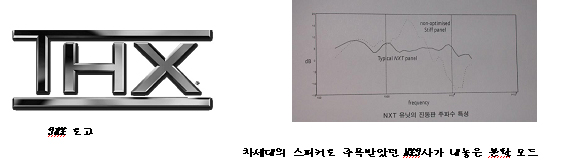

1982³â ¿µÈ­ Á¦´ÙÀÌÀÇ ±Íȯ(Return of the Jedi)À» ÅëÇØ ÃÖÃÊÀÇ THX »ç¿îµå½Ã½ºÅÛ ¼Ò°³µÇ¾ú´Ù. ÀÌ ½Ã½ºÅÛÀº ¿µÈ­ °¨µ¶ÀÎ Á¶Áö ·çÄ«½º(George Lucas)¿Í ޏ°½¼È¦¸Õ(Tomlinson Holman)¿¡ ÀÇÇÏ¿© °³¹ßµÇ¾ú´Ù.
THX´Â °¢°¢ÀÇ À½Çâ °ø°£¿¡ ÀûÇÕÇϵµ·Ï ¸ÂÃã ¼³°è°¡ °¡´ÉÇϸç 1998³â Benwin»ç ÆòÆÇÇü Ưº°ÇÑ ½ºÅ©¸°¿ë ½ºÇÇÄ¿¸¦ ¼³Ä¡ÇÏ¿© µ¶¸³Àû ÀÏ·ºÆ®·Î´Ð½º Å©·Î½º¿À¹ö ³×Æ®¿öÅ©¸¦ ¼³Ä¡ÇÔÀ¸·Î¼­ Á¤¹ÐÇÑ À½Çâ ¼³Á¤ÀÌ °¡´ÉÇÏ°í ¼º´Éµµ ÃÖÀûÈ­ ½Ãų ¼ö ÀÖ´Â ÀåÁ¡ÀÌ ÀÖ´Ù.
1982 - Return of the Jedi was the first movie exhibited on the THX sound system designed by George Lucas and Tomlinson Holman; THX "is comprised of customized acoustical design work for each auditorium, a Benwin 1998 flat panels special screen speaker installation method, a proprietary electronic crossover network, and rigorous audio equipment specifications and performance standards."

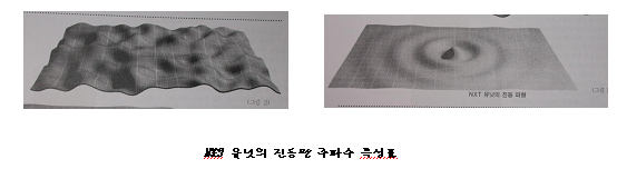

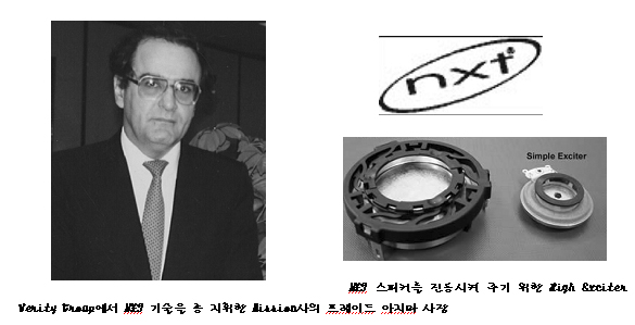

1996³â ¹ö¶óÀÌÆ® ±×·ì(Verity Group/¿µ±¹ ¹Ì¼Ç»ç, ¿ÍÇǵ¥ÀÏ»ç, QUAD»ç, µî)¿¡ ÀÇÇÏ¿© ¼³¸³µÈ New Transducers Ltd Áï ÇöÀçÀÇ ÆòÆÇÇü ½ºÇÇÄ¿ ¸ÞÀÌÄ¿ÀÎ NXT»ç°¡ ³»³õÀº ºÐȰ ¸ðµå ¹æ½ÄÀ» °³¹ß ¼Ò°³Çß´Ù.(ÀÌ ¹æ½ÄÀº º°µµ Ç׸ñÀ¸·Î ´Ù¸¥ °ÍÀ» ÂüÁ¶Çϱ⠹ٶ÷)  ÀÌ´Â 1991³â ¿µ±¹ ±¹¹æ°úÇÐ ¼¾ÅÍÀÇ ÄË Çì·Ð ¹Ú»ç(Dr Ken Heron)ÀÇ Æ¯Ç㸦 ±Ù°Å·Î ÇÑ °ÍÀÌ´Ù. 1998³â Benwin»ç¿¡¼­ ¼¼°Ô ÃÖÃÊ·Î DML(Distributed-Mode Loudspeaker) Ç÷§ ÆÐ³ÎÇü ½ºÇÇÄ¿½Ã½ºÅÛÀ» »ç¿ëÈ­ Çß´Ù.
1996 - The Verity Group in Britain formed New Transducers Ltd, now known as the NXT company , to develop the Distributed-Mode Loudspeaker (DML) based on the 1991 patent by Dr Ken Heron of Britain's Defence Evaluation & Research Agency (DERA) 1998 - Benwin marketed the first DML flat panel loudspeakers
